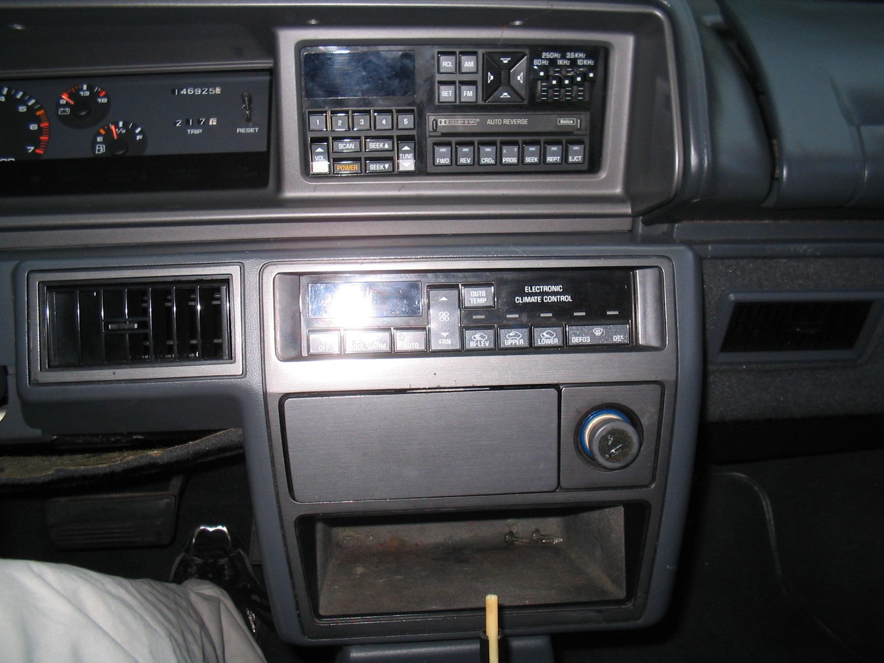

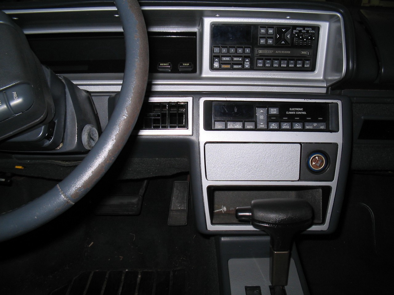

I've done a little work on the interior in the past with some spare trim panels. I painted them hammered silver, they have a nice real 3D texture, they're not just flat silver. I'm not thrilled about the result but I think it's better then stock. I'm thinking I'll do carbon fiber in the future.
Before:
After:

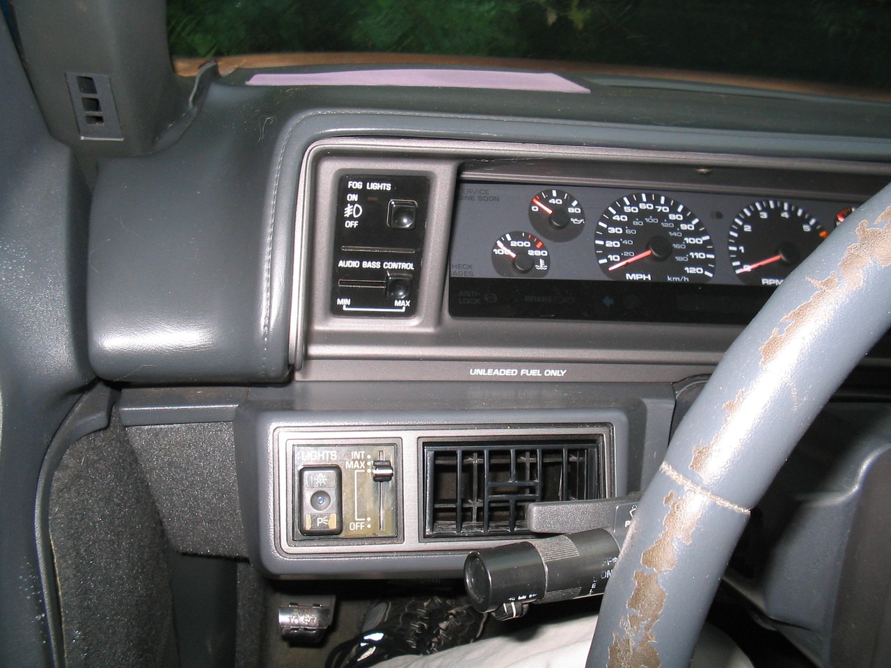

I also swapped out the stock analog gauge cluster for the one used on the International model Cutlass (watch the video):

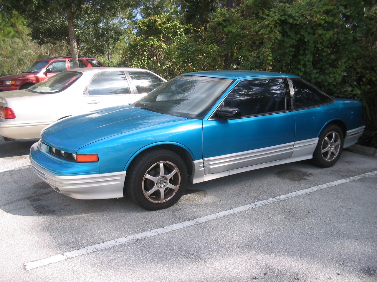

The Cutlass has sat nearly unused for years now. It saw some use while doing a headgasket job on the Legend a few years ago. Then its passenger side window was shattered when the lawnmower threw a rock at it. Then the wheels were stolen and the car was left sitting on bricks for 2 months. Eventually the cops found the thief when he was wanted for another crime of attempted murder. Prints matched the grease-stains the idiot left behind all over the fender and quarter panel. So I got the wheels and tires back, the tires were worn down to the threads, and one of the wheels had a massive gouge in it. That settled, it resumed its duties in the driveway, and sat around some more.

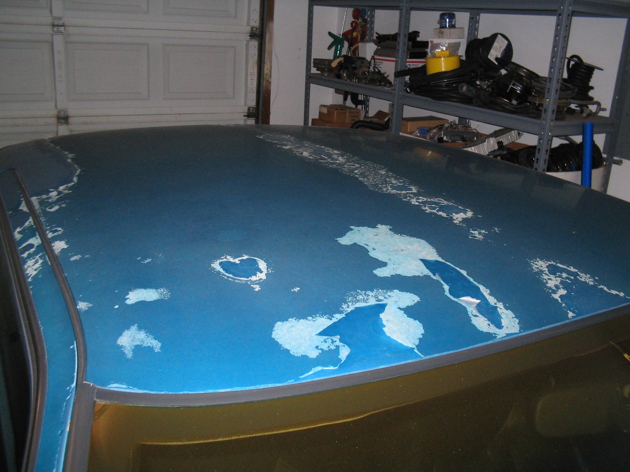

This car is a first-generation GM W-body. It has a 3.1L V6 (LH0), which puts out something like 4 HP and 6 Ft-Lbs of torque. That's what if feels like, at least. According to GM, it's actually 140 HP and 185 Ft-Lbs. It stalls for no apparent reason if you're too light on the throttle from a stop . The custom paint job turned out to have been very poorly done, and all of the clear is peeling off.

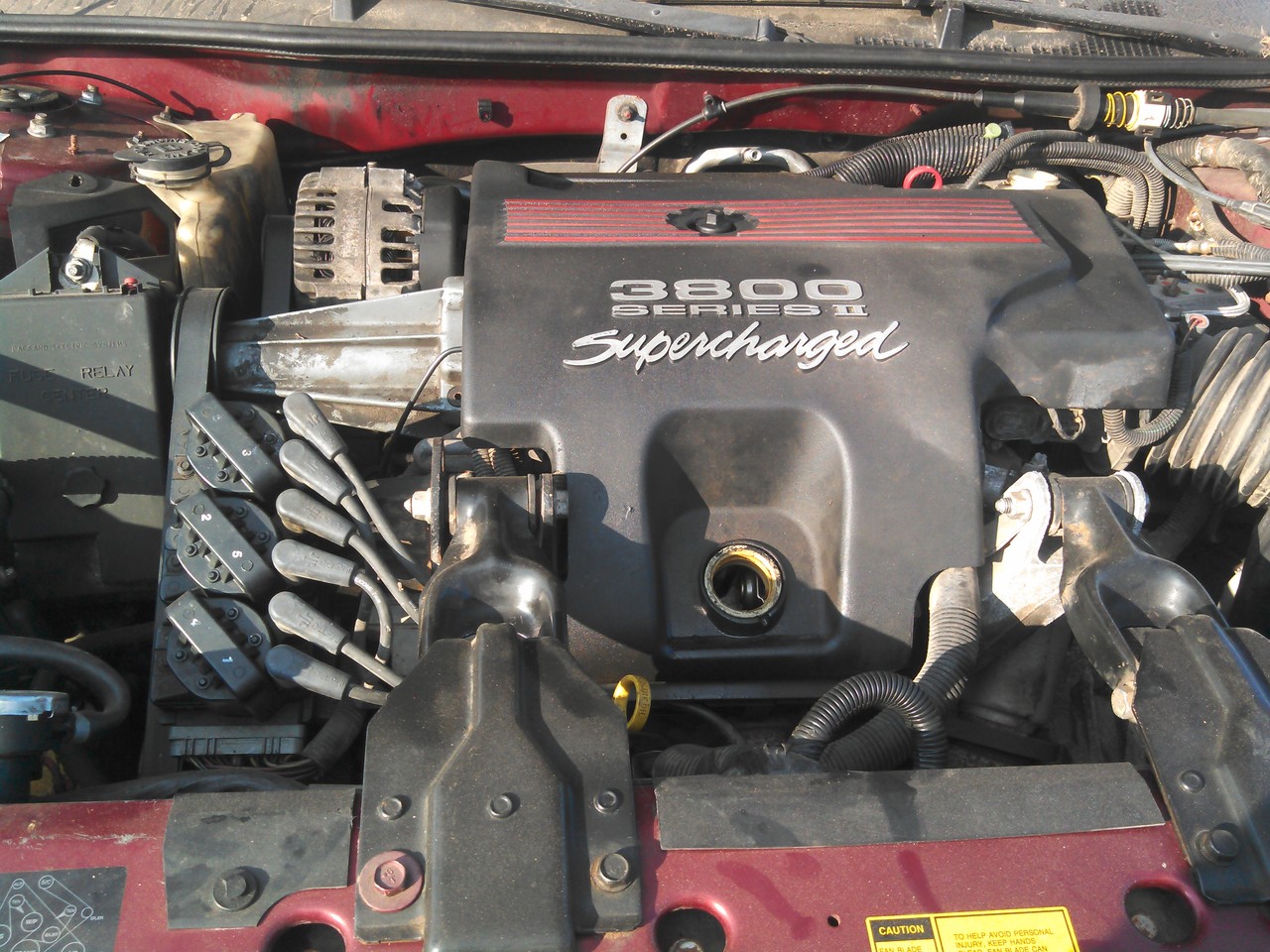

So here's the plan... To start with, I'm taking out the engine and transmission (4T60), and swapping in a Buick 3.8L V6. It's a very common engine, also known as the 3800. It's used in cars like the Grand Prix GTP/GTX, Regal GS/GSX, Monte Carlo SS, Impala SS, Bonneville SSEi, and tons of other cars had different versions of the same 3800, both supercharged and not. The one I'm going to be using is a supercharged "Series II" (L67). It uses a Generation III Eaton M90. It makes roughly 260 HP and 310 Ft-Lbs of torque. The engine has massive aftermarket support, tons of cheap parts, and basic bolt-on mods can give you pretty significant power jumps. The new transmission will be a 4T65e-HD, electronically controlled rather than vacuum controlled like the 4T60.
The L67/3800 is a common swap, so I am by no means doing anything unique. Although in a W-body it's nowhere near as simple and well documented as the C35 swap is for the Legend. There are two donor cars that simplify installation into the Cutlass, the Regal and Grand Prix. Both of these are also W-bodies so they have all the correct mounts and brackets. Other parts will need to come from the Monte Carlo, Lumina, Intrigue. Axles need to be custom-assembled using the inner half from the donor car and the outer half from your own. You also have to do a complete swap to OBDII and a custom tune is required.

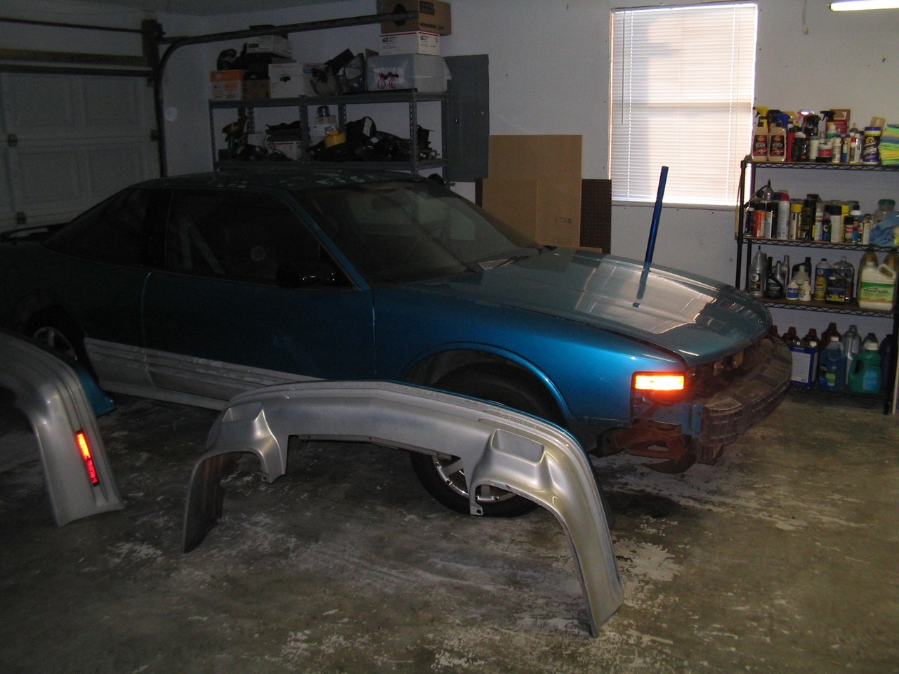

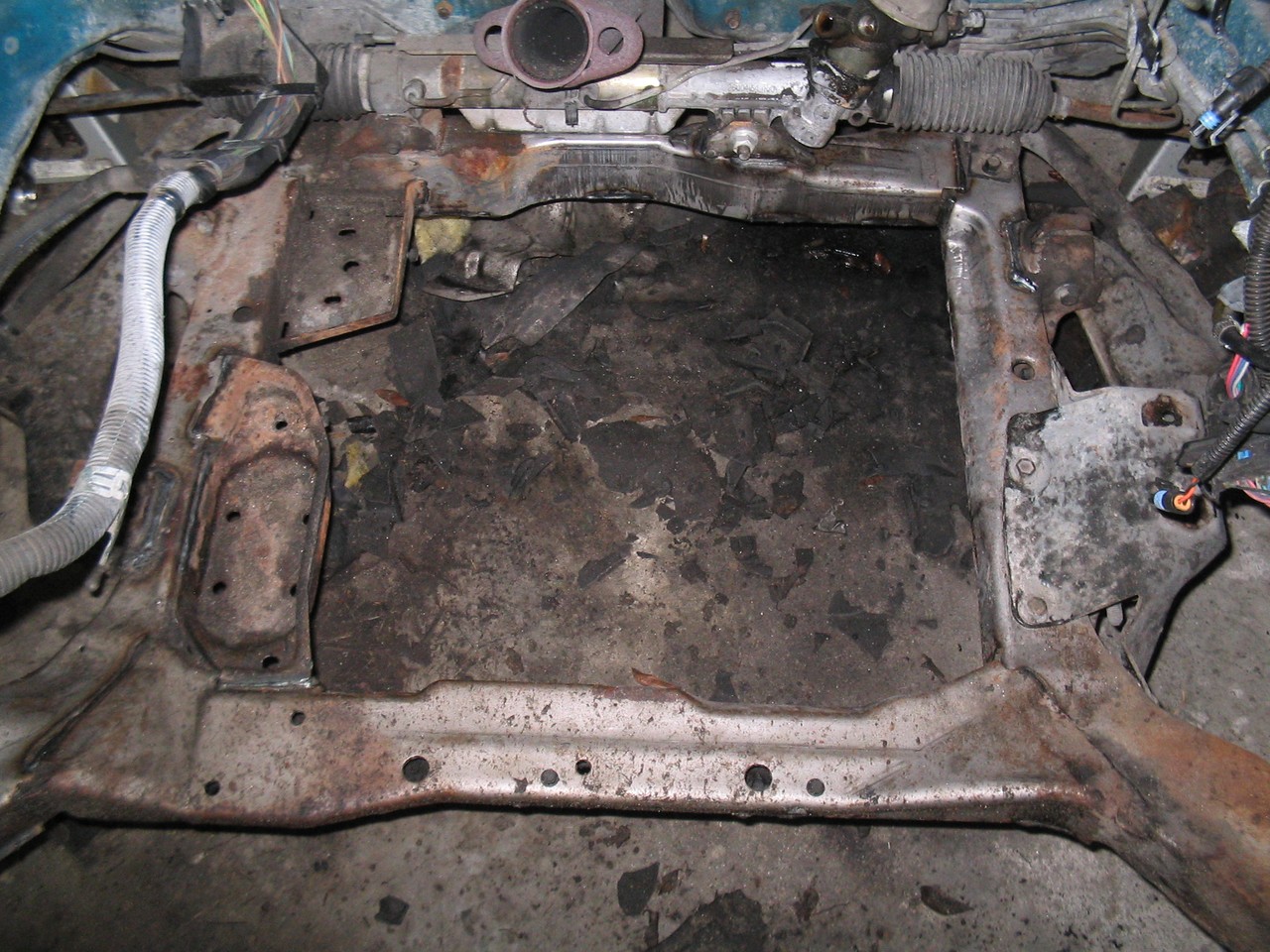

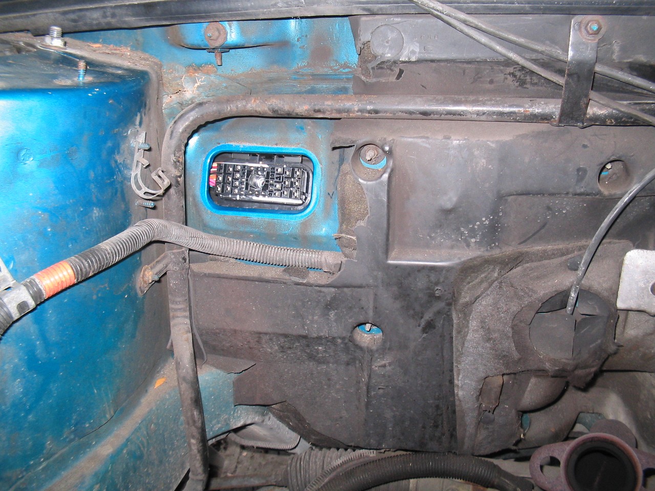

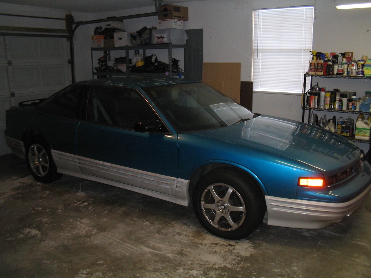

Is anybody still reading? I spent the weekend cleaning up the garage to get myself as much room as possible. This is likely going to be a slow swap/build, but I finally started it. Today I evicted the Legend and pulled the Cutlass in.

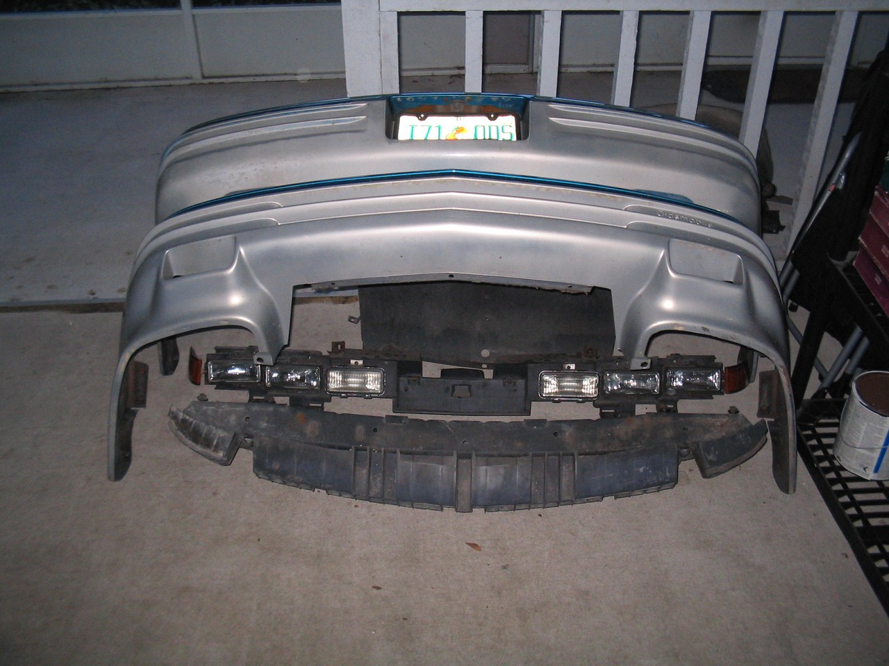

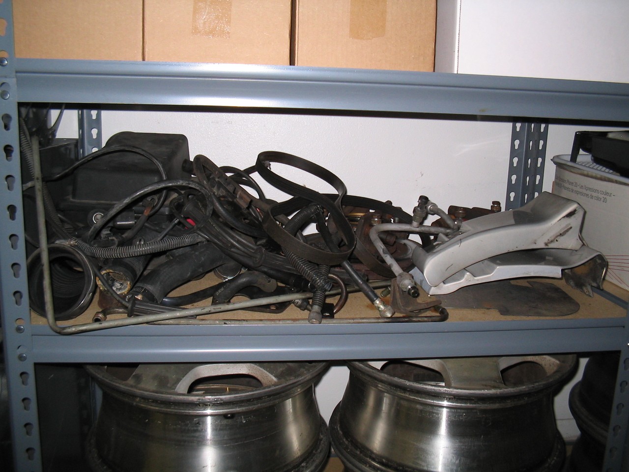

Didn't do much else today. I removed the front and rear bumpers for clearance. GM likes to use screws rather than bolts and u-clips rather than nuts , many of which I broke .

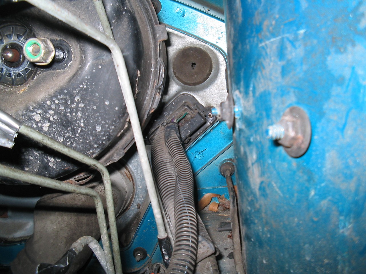

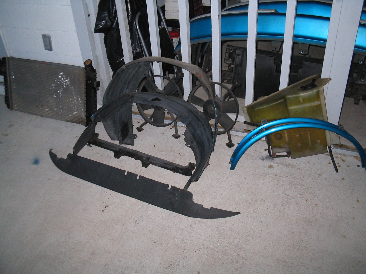

Drained the coolant, removed the radiator fans, air intake, coilpacks, coolant reservoir, battery cables. And... that's all I did today! It's not much, but I finally started.
