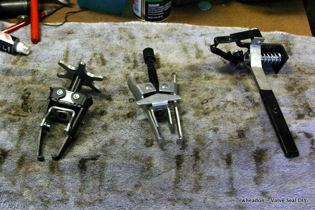

* spring compression tool 1
* spring compression tool 2
* spring compression tool 3

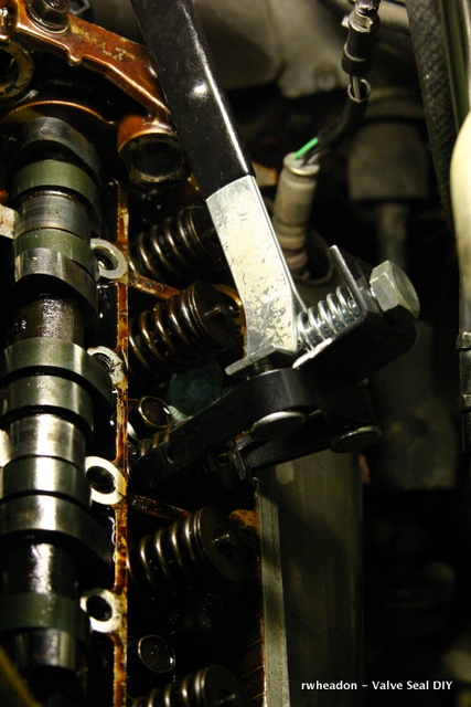

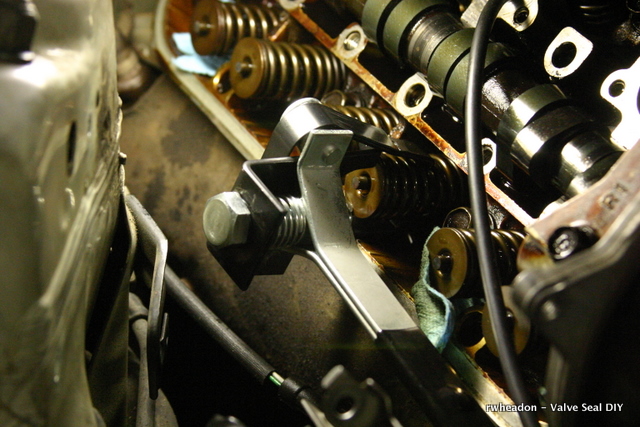

TOOL WARNING: I used 3 different valve spring compressors for the job due to various issues I encountered with space. The one that worked the best for the Legend's tight engine bay (90 degree tool) was perhaps the most treacherous of the three... but the only one that worked in such close quarters. I had to make some minor mods to all of my compressors, which I will cover here with some snapshots.
I needed to make some modifications to the long handle tool (90 degree handle).
* Removed the rocker cam and installed the bolt, this took about 1.5 inches or more off for better clearance
* The claw fingers had an angle that was far too aggressive, so I made it more into a 90 degree at the end where you hook the spring.
* The claw arms were far too wide for a couple of the rearward spring boxes, so I ground them down quite a bit into a narrower footprint.
You likely will be able to use power tools for your seal replacement, this is a luxury I didn't always have since my daughter was often asleep right above the garage.

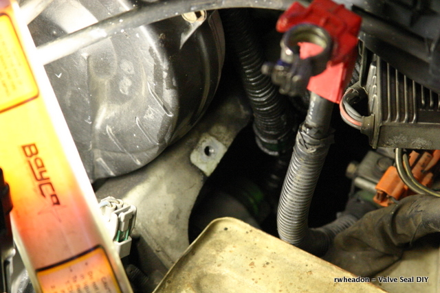

1. Remove the battery, tray, and release the wire harness from the alternator bracket.

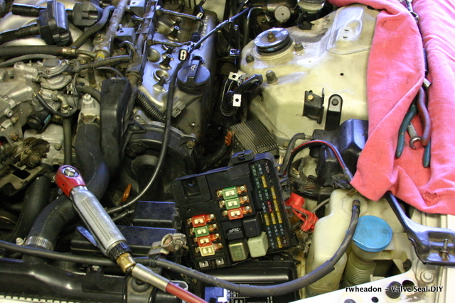

2. Remove the fuel filter and bracket
3. Take the engine fuse box loose and out of the way

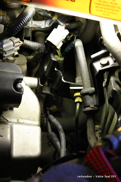

4. loosen/remove all those little metal brackets on the left strut tower (facing the engine)
5. at the rear of the left valve cover there are several brackets you will want to get out of your way.

10. Disconnect the engine wire harness. (right there at your ABS reservoir) get a bungie cord and peel the wire harness to the center of your engine, over the plenum. (You will be disconnecting mounting points and connectors iteratively until it is loose and out of your way.)
11. Remove the ABS heat shield/cover.

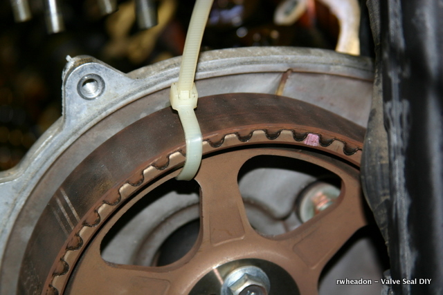

15. Strap a nylon strip (zip tie) on each of the cam pulleys to keep the TB in place.

* Two bolts to loosen the bypass pipe on the passenger side valve cover
* One bolt holding the harness to the rear of the passenger valve cover
* You need to unplug the passenger side harness from the connectors at the ABS module and peel it back to the center of your engine to get it out of the way.
* O2 Sensor harnesses at the bottom of each valve cover, just pop out the rubber pieces from the bracket
* One bolt holding the wire harness bracket at the front of the driver's valve cover

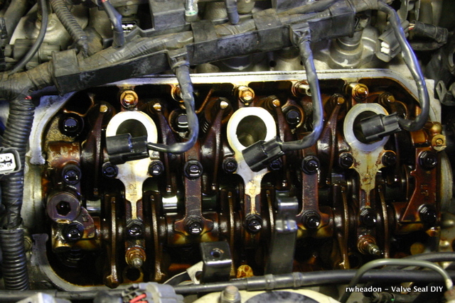

Old 12-13-2010, 02:58 PM   #3

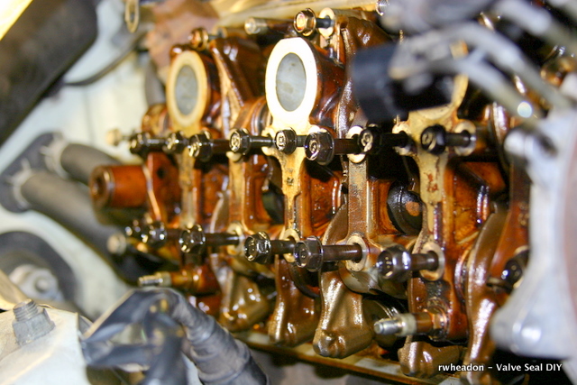

Default Remove the rocker assembly
Remove the rocker assembly:

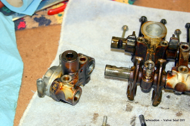

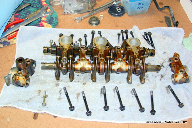

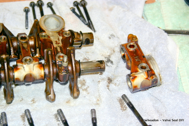

WARNING: DO NOT REMOVE ROCKER BOLTS FROM THE ASSEMBLY, DOING SO COULD CAUSE IT TO COME APART IN YOUR HANDS!
1. Loosen the 18 rocker assembly bolts and thump the assembly with your rubber mallet to break it loose. Now completely loosen (BUT DO NOT REMOVE) the rocker bolts.
2. Lift the rocker assemblies off of the head. Take care to keep the cam in place as much as possible. (The tie strap will keep your belt from slipping off the pulley)

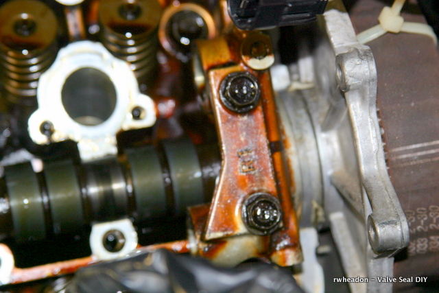

3. At your work surface carefully remove ONLY the 4 12mm bolts from each rocker end cap (front / rear) and slide the end caps off. One of the end caps will still have 2 10mm bolts in it, remove those bolts. Take note of where each end cap goes and make sure any spring washers are left with the assembly, you don't want to lose them in your engine bay. DO WHATEVER YOU NEED TO DO FOR INSURANCE AGAINST PUTTING THINGS BACK TOGETHER WRONG... I just left things laying out in exactly the order they belonged.
^I was a near moron to remove those bolts... made more work for me.

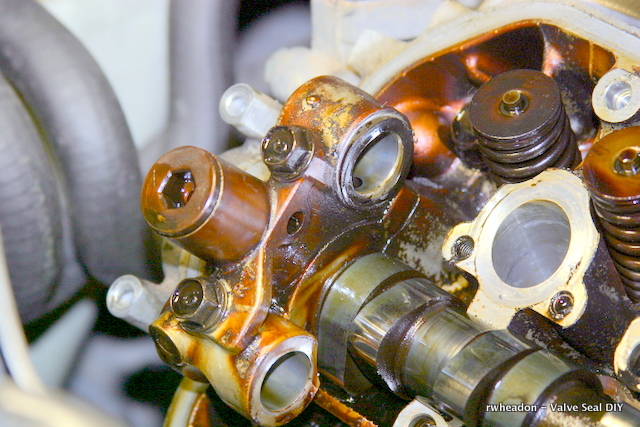

4. Install the end caps back onto the head, this will secure your camshafts.
^ notice on that upper port that I had forgotten to leave the spring washer on my table... could have been lost easily.
5. Once the caps are bolted down you can remove the zip ties.

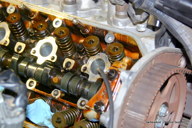

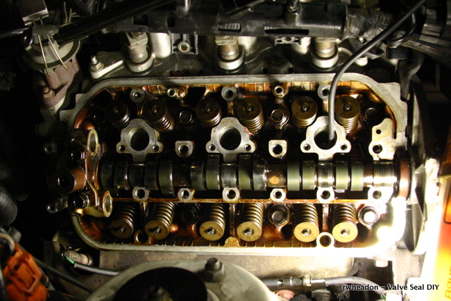

You are now set up for being able to crank the motor around. Some people use compressed air to keep the valves from falling into the combustion chamber when springs are removed, I prefer not to endure the loud noises from my air compressor and have chosen a low tech method using vacuum hose coiled into the chamber.
1. Install the vacuum hose in the next cylinder with a piston starting it's trip up to the top. (I don't have a specific order I worked in... my gauge of the next candidate was with a 24" philips screwdriver to see which hole was deepest) Thread the hose in through the spark plug hole. Once the hose touches the piston you will start coiling it by twisting the hose (pick ONE direction) while pushing more in. When you have 2 or 3 feet of hose coiled into the cylinder you can move to step 2.
2. Turn the crank until the piston stops on your vacuum hose. (The crank will not turn any more)
3. Give the vacuum hose a gentle tug to make sure everything is snug.
4. Replace your seals. (jump to "Replacing the valve seals" Step 1.)
5. Back the piston off of the hose by going CCW slightly.
6. Pull the hose out of the chamber, it should come out easily.

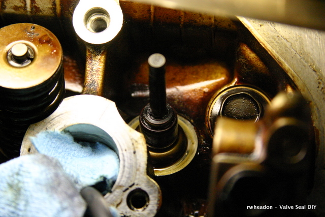

Old 12-13-2010, 03:04 PM   #5

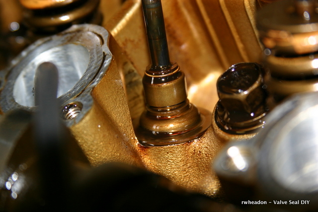

Default Replacing the valve seals
Replacing the valve seals:
NOTE: I have iteratively accumulated 3 valve spring compression tools. Every time I hit a point where one would not work I ran out and found a different type. See my tools section for the 3 types that ended up working for this on the car project. The one that I modified by taking the cam handle off was the only one I could fit in the tightest conditions... but due to precarious arm design it also shot a few washers across the room. If you are the "real man" type who doesn't use safety glasses then I suggest you swallow your pride and put something over your eyes for this job, I did get hit once.
1. Go ahead and set 4 seals out so you can keep track of your work, when they are gone then you are done with that cylinder.
2. Pick a spring and install the compression tool.
3. Crank the compressor down until you meet firm resistance. DO NOT OVER TIGHTEN OR THE ARMS WILL DISENGAGE AND YOU COULD END UP HUNTING FOR PARTS.

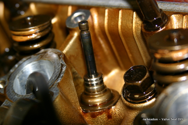

4. Using the pocket magnet retrieve keepers from the spring washer as you push the spring downward (away from the top of the stem where the keepers live). Put the keepers in a safe place.
5. Remove the spring and set it aside, do not remove it from the tool.
NOTE: After having one come loose while it sat on my table I began to set the compressed assembly on a towel and doubling it over.
6. Remove the old valve stem seal. I use long nosed vacuum hose pliers. (see tool section)
7. Clean the seat of shredded rubber pieces.

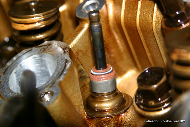

8. Apply a couple drops of oil to the valve stem.
9. Apply a drop of oil to the seal's hole where it rides the valve stem.
10. Gently start the seal onto the valve stem. Sometimes you have a guide to use for this and sometimes you don't ... just be careful and you will be fine.
11. Once you clear the groove on valve stem continue pushing down and onto the seat, you will feel a noticeable bump when the seal snaps into the seat.
12. With the 11mm socket and knuckle buster gently tap on the seal until you hear it bottom out. DO NOT become over zealous on the seal.
13. Re-install spring.
14. Install the keepers. I have no advice for you on this, it will either be easy or a pain for you. Watch the video at this post's beginning if you want to see me do it. Once you have the keepers in place you will want to keep pressure on them by lifting up on the compression tool.
15. Loosen the compression tool to relax the valve spring. Remove the tool when spring is fully extended upon the keepers.
16. Gently tap the end of the valve to make sure the keepers are seated.
17. With a sharpie make a mark on the spring washer so you know that one is done.
18. Move on to the next valve until you run out of seals you set out on step 1.
19. Jump back to "Setting the chamber up for valve stem seal replacement" Step 5.
