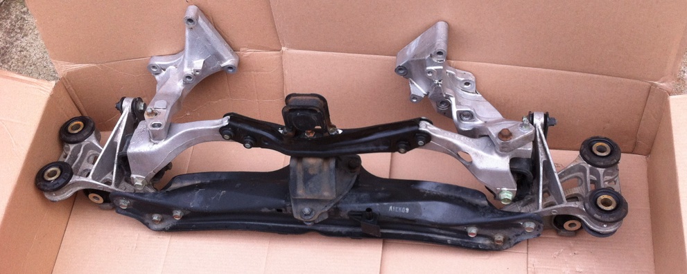

The whole crossmember system is different 93-95 and won't accomodate the 91/92 without swapping over quite a few parts.
If the 93-95 crossmember system conversion is what the poster wants then he will need the front crossmember complete including PS bracket/mount and Alternator bracket/mount. I just went through all that in the past couple weeks.
Here's a picture of everything needed if you want to convert those bushing brackets from 91/92 to 93+:
AFAIK there is no piecemeal way to pull it off.
EDIT: I think the bore of the hole for the 91/92 Mount to fit into the bracket is different from the 93+ for the bushing brackets. I believe Alperovich wrote something up on it somewhere but I'm too lazy to search for it. (Something like 91-92 brackets work fine in a 93-95 but 93-95 brackets need drilled out for a 91-92.) I have both complete setups in the garage, I'll try to compare them tomorrow

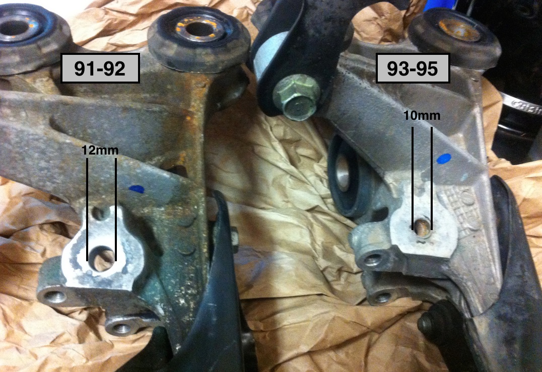

Sorry for the delay tito, it was a lot of work to clear a path, retrieve, unbox and take pictures of these crossmembers.
There are various subtle differences in the brackets which I didn't worry about in this exercise because the final geometry looks to be about spot on between the two, but there is a difference in bore of mount holes. I bought complete crossmember assemblies because if I personally am going to use the newer brackets then I'm going all the way.
The 91-92 style bracket has a 12mm (12.214mm) bore and the 93-95 style hole has a 10mm (9.835mm) bore. I didn't try to be absolutely precise in these measurements so they could be +-.255mm or more.
That difference between bore holes makes sense because in 91-92 that point actually was a seat for the mount where in 93-95 the mount is actually positioned in the crossmember's center and those two side pieces are just dampers. This is how they got rid of the eerie rumble at 1100-1300 rpm I believe. (and therefore the poly filled "mounts" are probably re-introducing the rumble.)
Here is a visual:
So the 93-95 mounts will probably work fine IF a 91-92 buyer takes them to have the bore drilled to fit 91-92 mount studs.

So thats the only difference? You just need to make sure that hole matches the 91-92 setup? i'm sure my mechanic would be able to make that hole bigger if thats the only difference.
